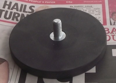

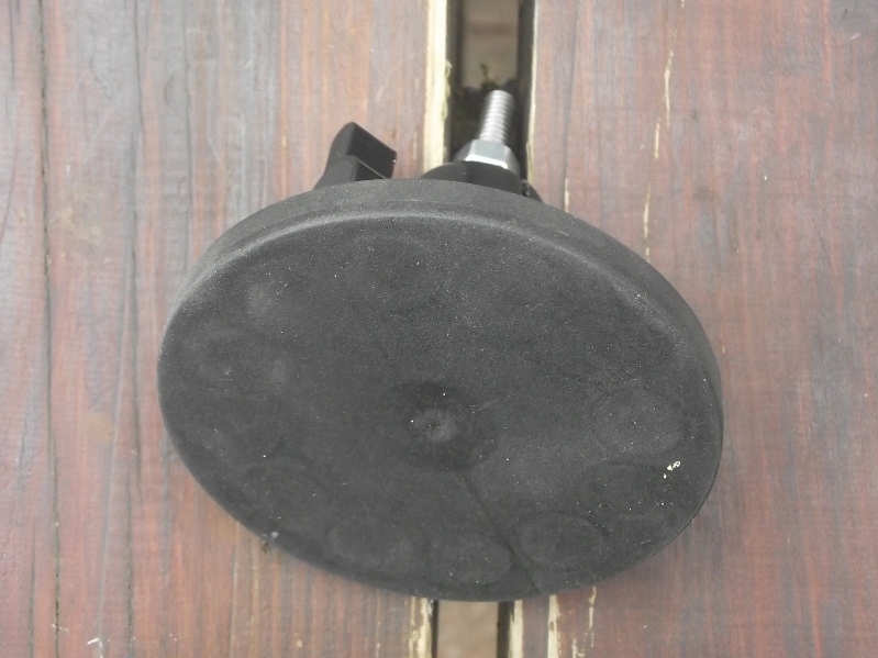

Well the magnet finally turned up and I naively plonked it on the freezer door to see how it holds... with little to grab hold of I had to use two hands to slide it over the edge of the door to release it. Look carefully and you'll see the imprint of 12 neodymium magnets around the base.

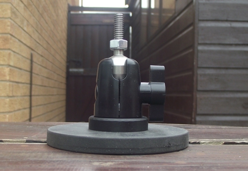

A bit of hobby lathe work and part of a heavy duty suction mount and upgraded stainless pivot ball stud adapts it quite nicely.
I think this clip shows how well some mag mounts can hold to a steel panel better than if it were shown on an actual car roof, in fact a mildly curved roof panel would make removal slightly easier.
