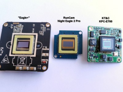

The camera has the Code name Eagle +.
One instance of the camera (FullAuto) is located in Scotland, at Bruce "Phoenix" MacPherson.
I can provide the camera in two versions:
1. A camera with "honest" 25 frames per second, an on-screen menu, settings, but the picture is cropped on the sides and has a 4:3 format. So, it is like RunCam Night Eagle Astro Edition with more NIR sensitivity sensor and another form-factor.
2. Fully automatic operation, no menu. The camera itself selects the number of frames per second, and the noise reduction level has a clearer picture in the dark. The aspect ratio of the frame is 16: 9. Despite the reduction in the number of frames, there are no loops behind moving objects.
This is exactly what you had on the test.
The price is £135 per camera, which is almost four times less than the Watec 910HX - https://www.modernastronomy.com/shop/ca ... ra-only-2/
A good price for a device that sees almost the same as Gen2+ IIT.
Payment via PayPal. PM me.

You can remove the 38x38mm printed circuit board from the case and use it to make your compact DIY NV devices.
In this case, I recommend using these super-fast lenses - https://aliexpress.com/item/4000824619748.html and https://aliexpress.com/item/4000824672223.html
