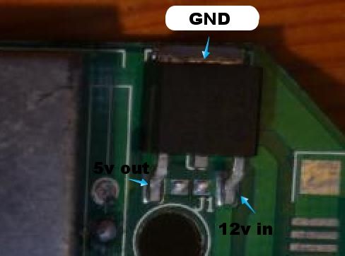

The reversing devices are designed to work in a car which has 12v readily available. Our DVR’s have a Cam-In socket which can power a 5V CMOS camera, we will use this 5v to power the receiver.
The 2 wires going into the circuit for the power can be followed to a regulator (the thing which gets really hot). This is getting hot because it is dropping the input voltage of 12v down to a usable 5v which the wireless module wants and throwing the rest off as heat, wasting power. You can see if this is outputting 5v by probing it with a multimeter, the black probe on the ground tab and the red probe to the right leg for 12v input and left leg for 5v output.
Follow the 5v output to somewhere else on the board that you can solder a wire to.

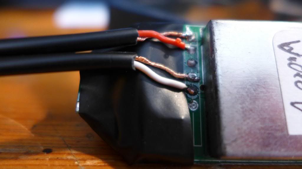

Solder your wires to the pads on the board. My board had silk screen print labels which made it easy for me to solder the connections.
Cover the board with electrical tape so the ground wires do not short, cable tie or hot glue the wire to the board.

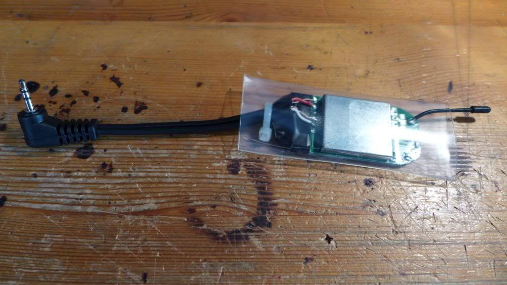

Cover the board with heat shrink tubing to protect it from the elements and from shorting against anything metal it may come into contact with.

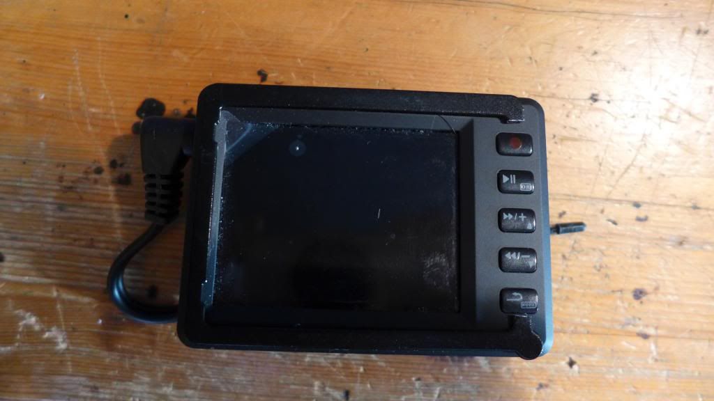

Attach some velcro onto the wireless dongle and to the back of the DVR for easy removal.
Conclusion
Turn on your DVR the dongle should start receiving video automatically.
This mod can be removed from your DVR very easily and it doesn’t require any extra batteries (your DVR battery might not last as long though).
