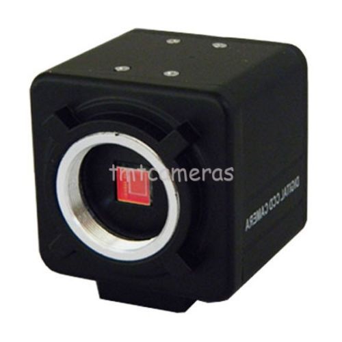

Has anyone tried one of these Sony CCD Nextchip 2090? How well would it work with a Spotter or scopeless?

hi I have a sony next chip very good ,but the privacy even though there is a menu setting it dont work, bought two cams at the same time,, the cam id worked fine though and infact makes a very good reticle and positions great, ir cut came of easy and they give a very good picture with ir, my ones have a sub menu that allows me to change colour if cam id ,

Nextchip manufacture the digital signal processor chip that goes between the sensor and the video output and which provides all the menu functions.
it's a competitor to the Sony Effio chips and gives camera manufacturers a choice of supplier even though they are using Sony sensors (Exview or SuperHAD)
Nextchip products are usually somewhat cheaper than the equivalent Sony Effio products, and, from what little research I've done, generally don't perform quite as well as their Sony counterparts.

Hmm, interesting. I have an idea how to use that to sort my scopless problems. I had pretty much abandoned my scopeless as the poi was too low on the image and shimming just made the mount unstable which shifted zero. With that camera I could house it, along with battery and viewfinder, in Ali box section very slightly bigger than the housing so that the camera could be adjusted to point in the right direction and then fixed with grub screws.
If they perform as well as the effio super HAD II sensor cameras then I'd be happy. Plus the multitude of cheap auto iris cs lenses to choose from is rather temting too.
